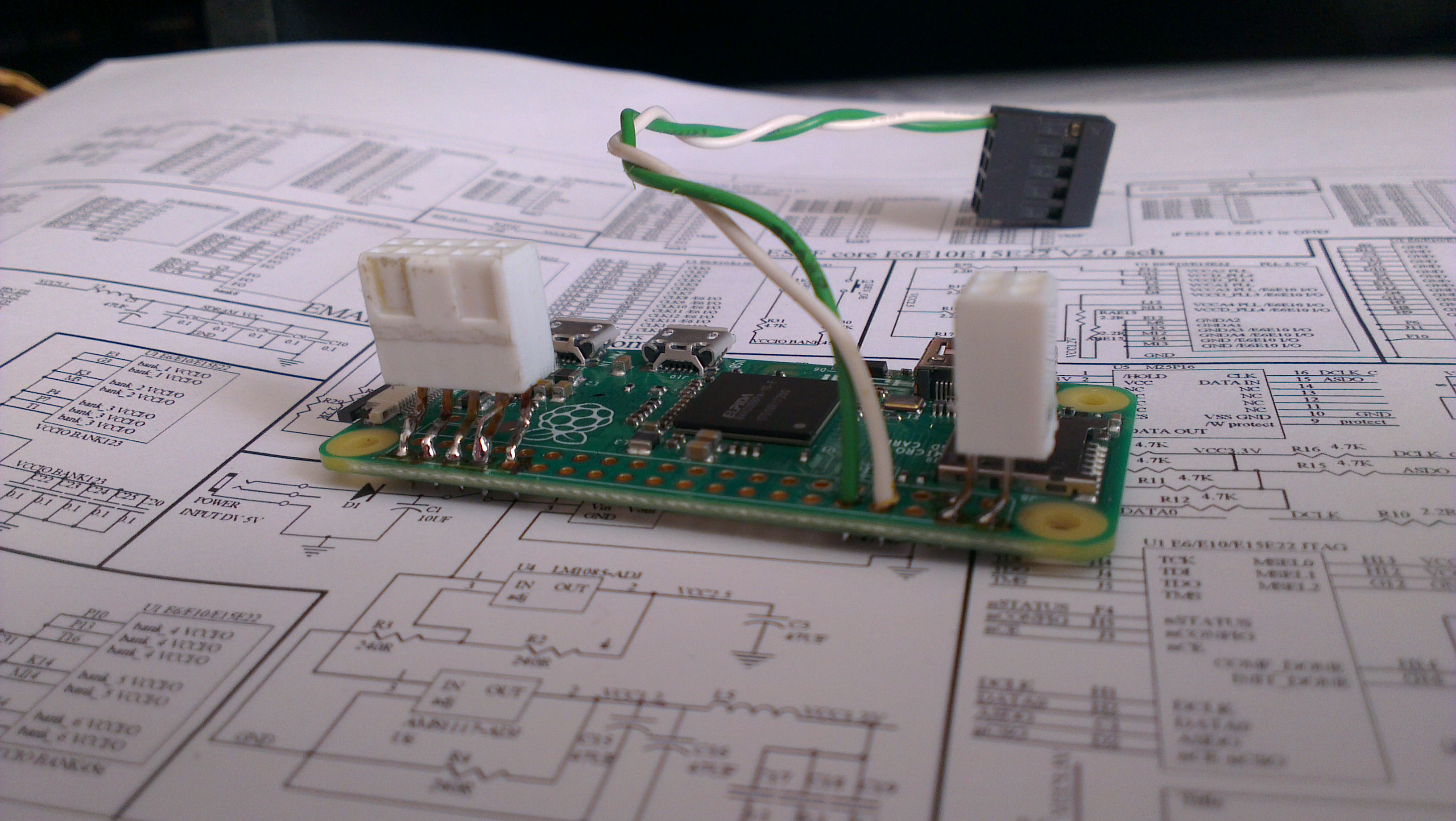

Quiero montar la raspberry sin usar el cable del usb blaster y me he hecho este esquema para aclararme. Tambien aprovecho para agradecer a david el tiempo que ha dedicado a sacar esto.

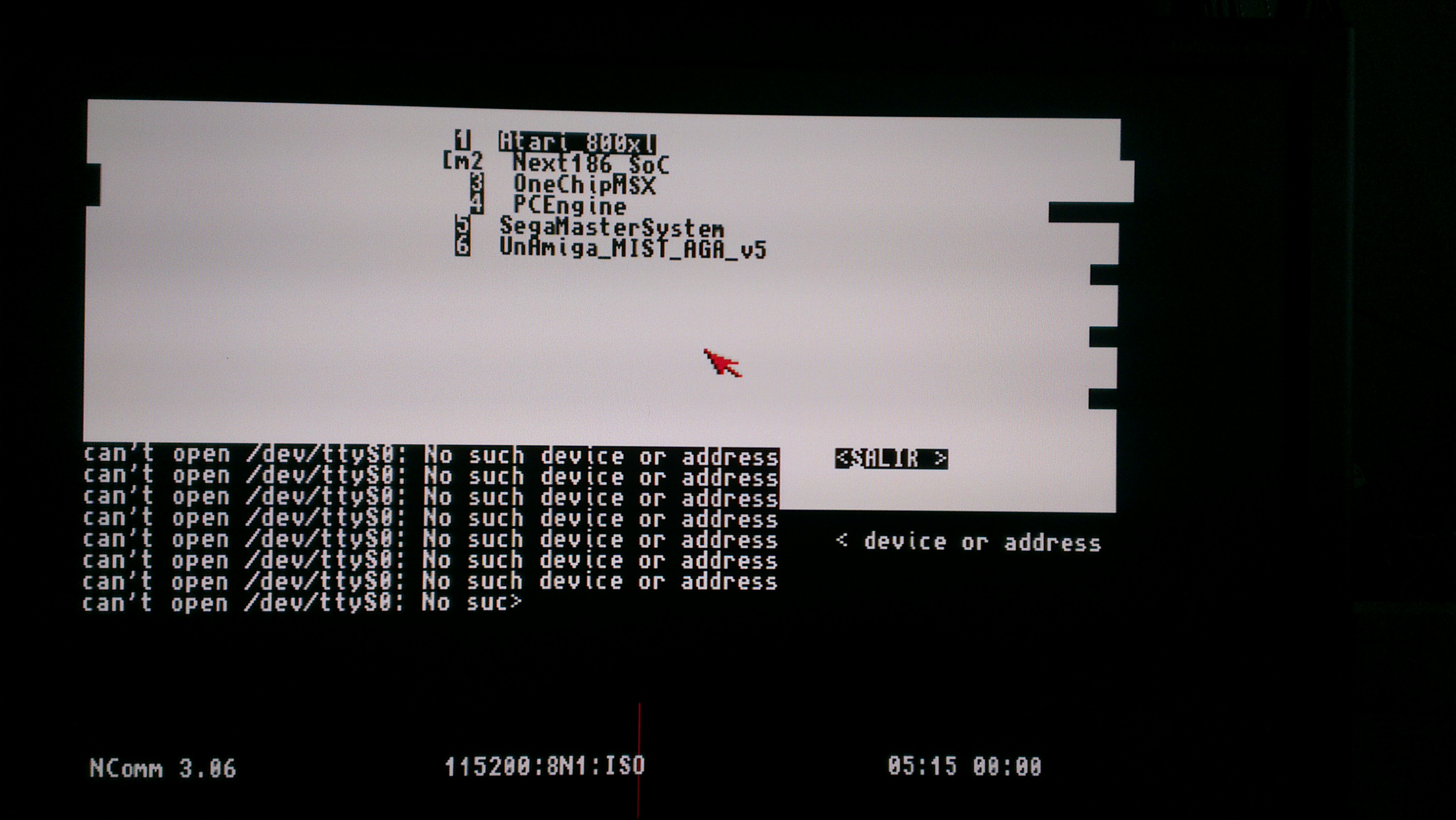

Hi All!
I try repeat this addon. But i have some trouble. The menu appears distorted. And the message "can`t open ..." is constantly repeated.
I'm thinking that the bitrate is too big. I tried to change it to 9600, but due to the lack of experience with LINUX, nothing worked for me.
Can anyone do the assembly of "UnAmiga_MultiCore" under the 9600 bit rate?

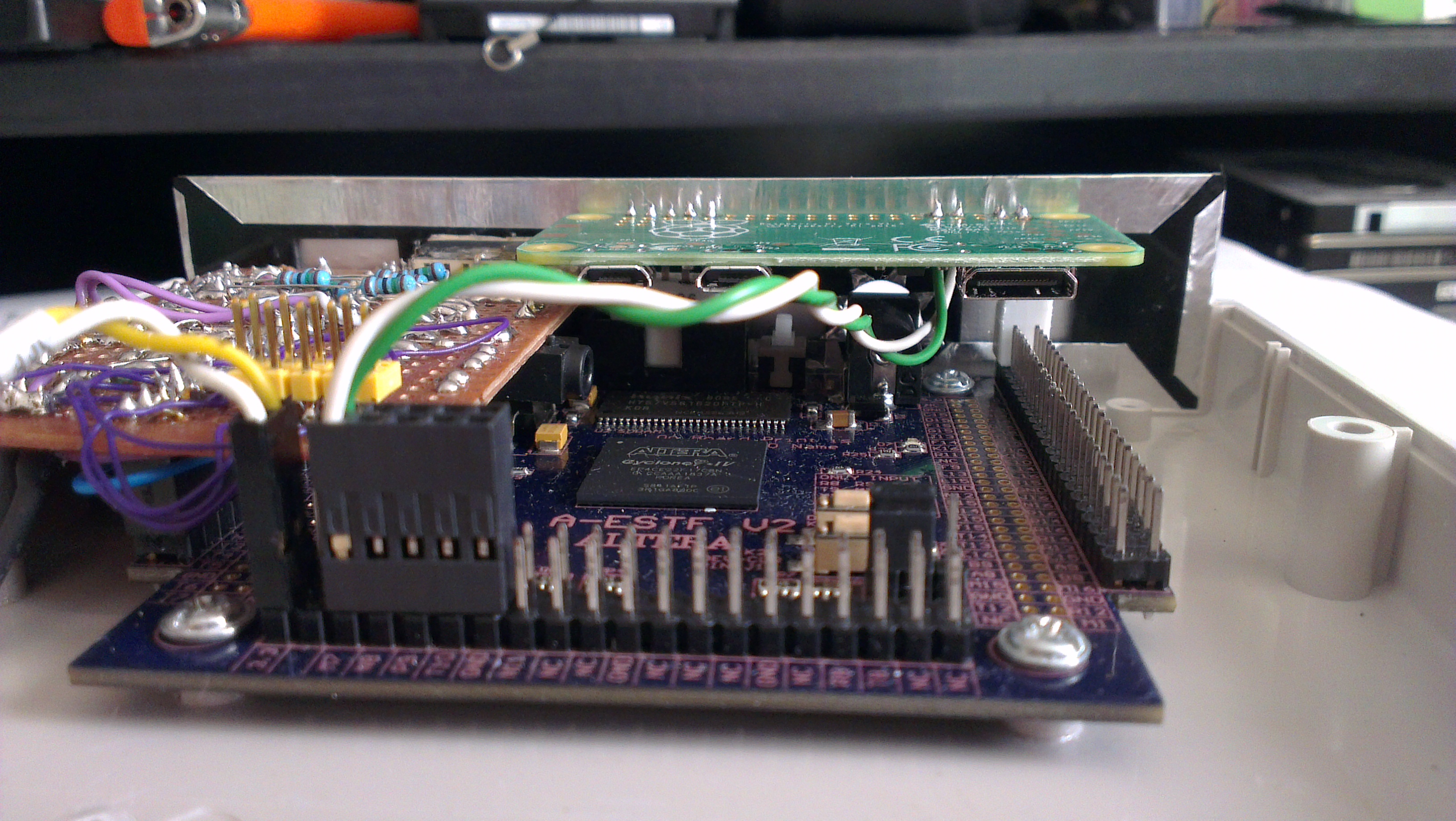

Photos of my device.
- IMAG0166.jpg (1.57 MiB) Visto 78993 veces
- IMAG0167.jpg (1.71 MiB) Visto 78993 veces

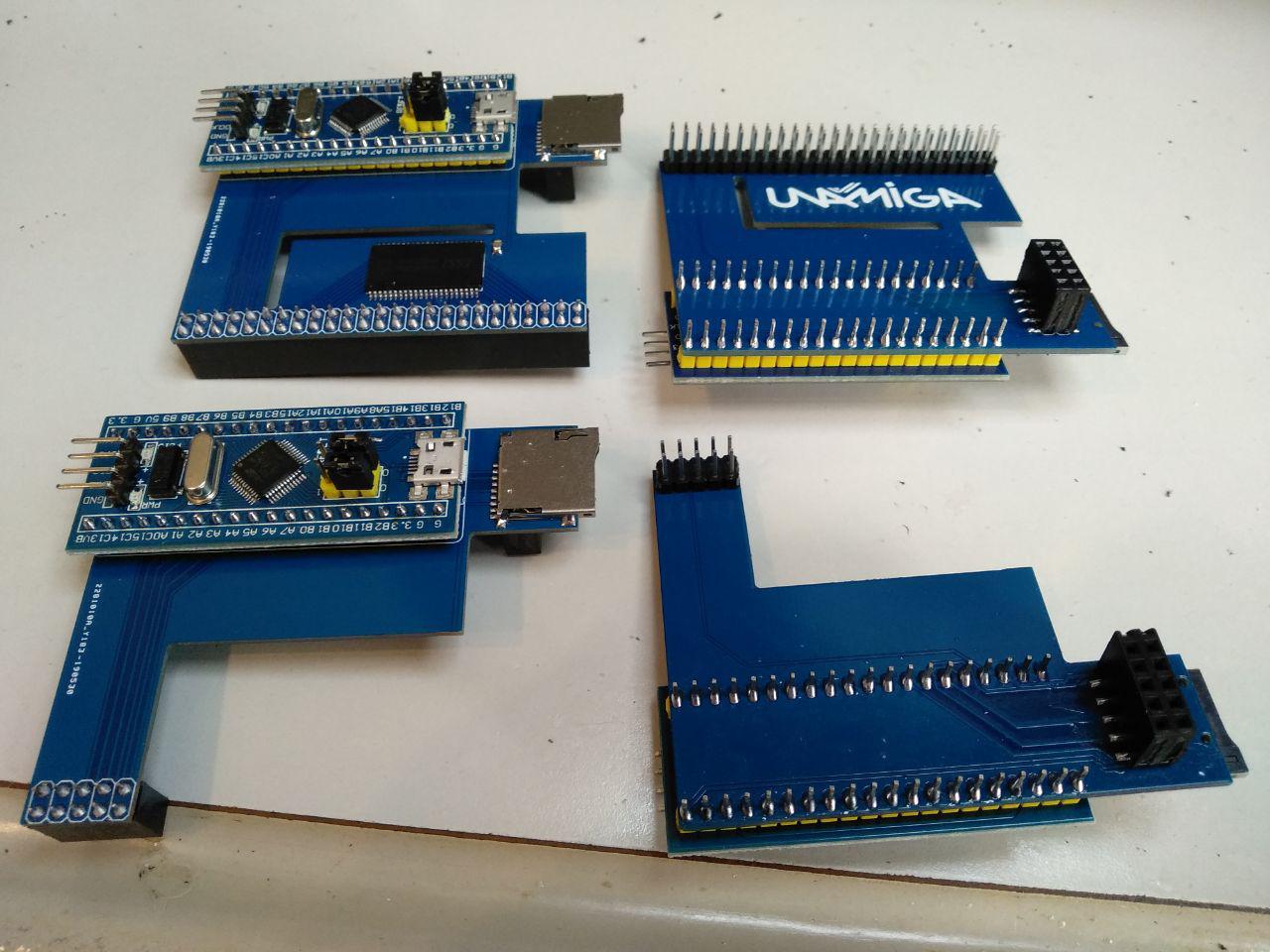

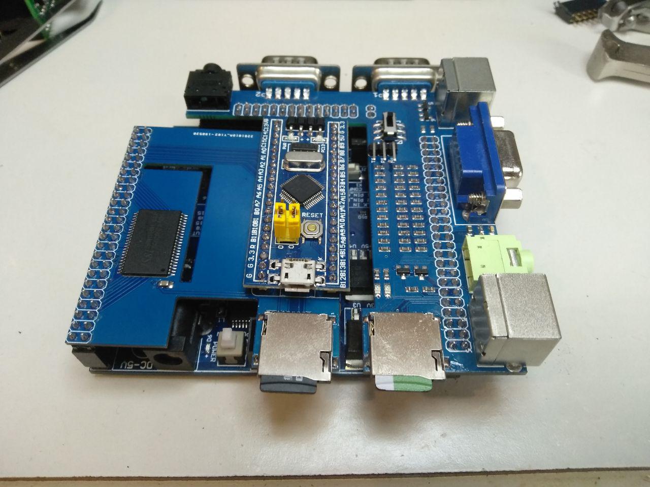

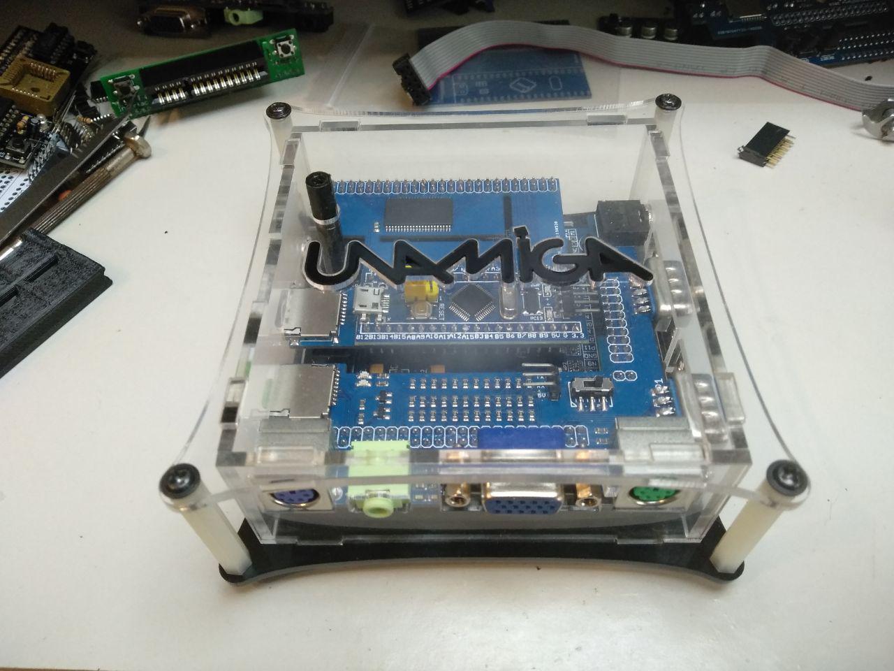

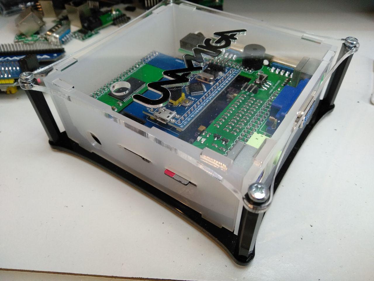

Now we use a better solution for multicore thanks to Fernando Mosquera. It's based on STM32 and can be with or without SRAM (for more core compatibility).
- photo_2019-09-03_09-40-30.jpg (148.18 KiB) Visto 78985 veces
- photo_2019-09-03_09-40-48.jpg (137.16 KiB) Visto 78985 veces
- photo_2019-09-03_09-41-35.jpg (143.17 KiB) Visto 78985 veces
- photo_2019-09-03_09-41-56.jpg (133.23 KiB) Visto 78985 veces

Hi Monstronio,
Apologises for my late reply.
The problem about the distortion on the menu screen looks like is being caused because of some kind of data speed problems, I guess you are having more information in the UART pins than the supported by the Pi Zero.
I guess your colours configuration in NComm may be higher than 4 colours.
You also have to put some "zero" values in the NComm modem configurations as shown in my post or you can try to use the SD images that contains a NComm preconfigured terminal program.
If you really want to change the UART baud speed, you need to change it in NComm and also in the Raspberry Pi config file.
The overheating problem you are experiencing may be caused by your power supply/adapter. If your power source is faulty or not capable of offer enought current for your complete system, then your Pi can fail. You can try with different adapters or even a powerbank, testing for your FPGA and Pi at the same time or to give power only for your Pi (disconnecting the positive power cable and using the microUSB connector).
Try to check your connections, you could have wrong connections that could be overheating your Pi.
Also, it appears your board have the famous "pink" letters colour tone, that looks like the chinese seller tried to "reflow" your FPGA board, and that could be origin of troubles also, because your FPGA current consumption could be higher than the correct comsumption of a properly working board.
Hope this helps. Good luck!

Hi DaCarSoft!
I can precisely exclude all hardware related issues. But - I have a version of Raspberry Pi without a WiFi module.
The message "can`t open ..." seems to be related to an attempt to initialize the WiFi module.
I think that several unsuccessful attempts to initialize a non-existent hardware leads to fail.

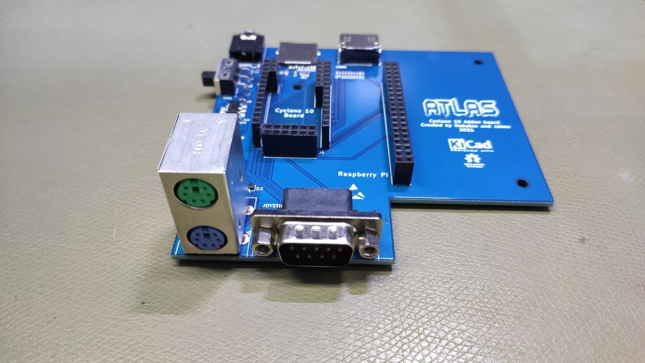

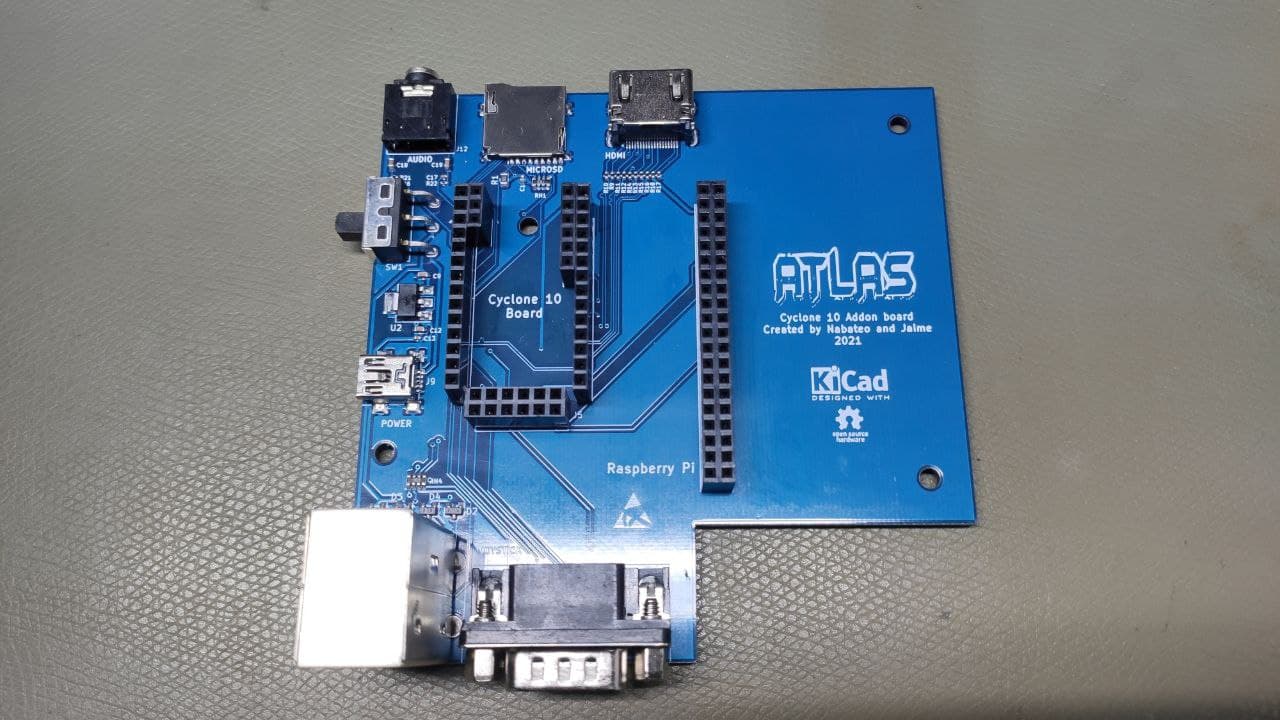

Re: Módulo "add-on" multicore para UnAmiga basado en Raspberry Pi
La atlas usa tu diseño de addon para que pueda pincharse directamente una pi que posea 40 pines.
Eres padre de la ATLAS, lo que hicimos fue intentar no cometer los fallos que se cometieron en unamiga al escoger una placa que fuera realmente dura "fpga con bus arduino" y de gran calidad como la cyc1000 y que tuviera en torno a 20kles lo que permitia tener cores retro muy interesantes desde la aparición de las Terasic DE1.
Es una plataforma donde aparentemente el quartus programa en poco tiempo.
Y por supuesto yo estoy esperanzado si intel proporciona a los desarrolladores de yosys información para que pueda ser parte de las fpgas soportadas por fpgawars.
En realidad es una IOBOARD ATLAS para una fpga en este caso CYC1000 y MAX1000.
- BUS PI Y BUS CYC1000.jpg (108.69 KiB) Visto 74428 veces
- MODELO PLACA AZUL PS2 Y DB9.jpg (91.04 KiB) Visto 74428 veces
