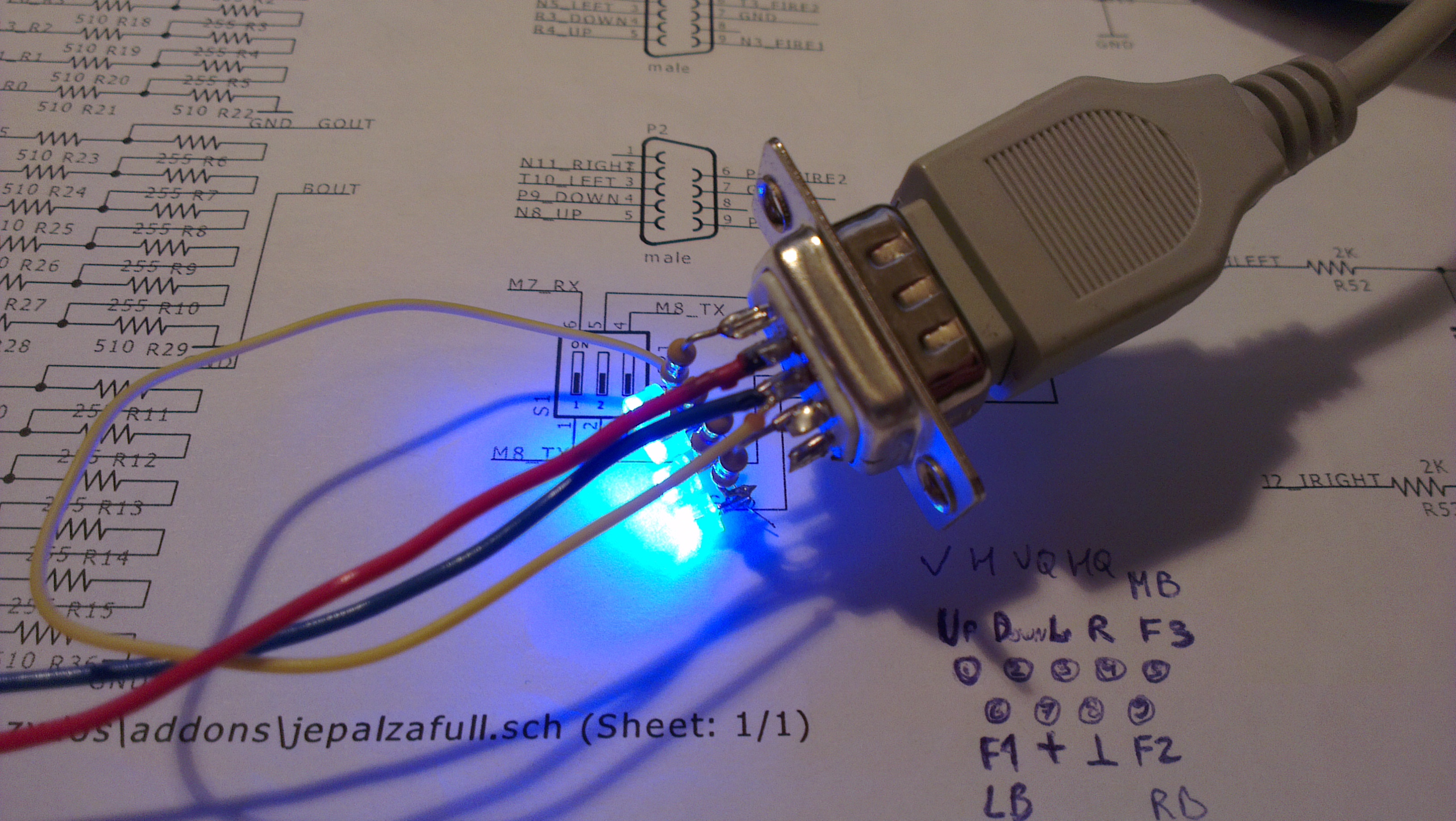

The theory of the Megadrive joysticks and the Atari Joystick in general is that in each position or if you press a button, the pin of each position is connected to the ground pin, and you close the circuit. There is not voltage crossing between the pins and GND, it is like a simple button. It is passive !!!
So, I recommend you test with a multi-meter the pins of the joystick in each position pressing and releasing, and you will realize what i am talking about.
Connect one extreme in pin 8 (GND) en the other extreme in any position and move the joystick.

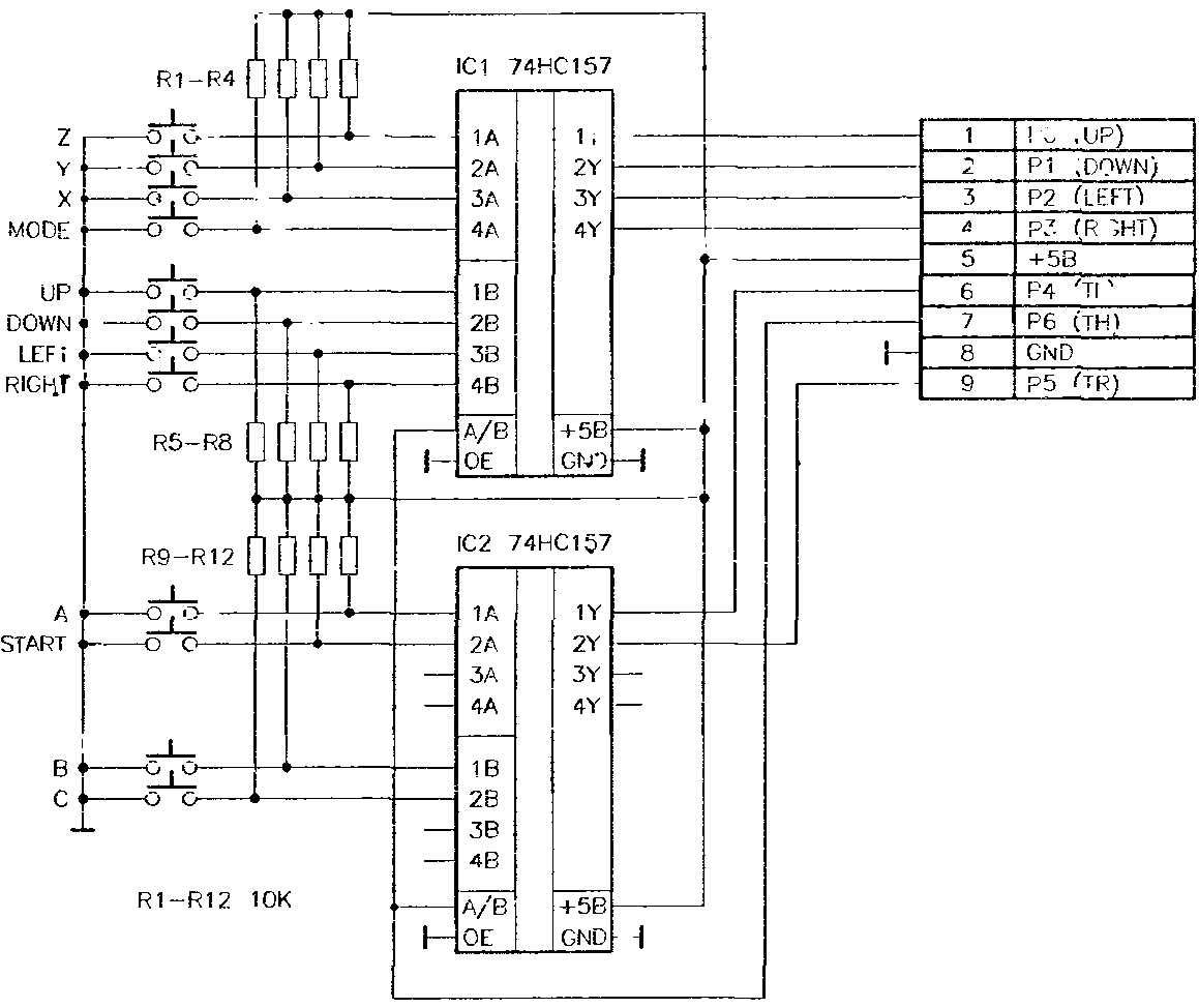

Here you have the pinout of the Sega Megadrive Joystick connector

It is passive !!!
NoOoOoOoOoOoOp!

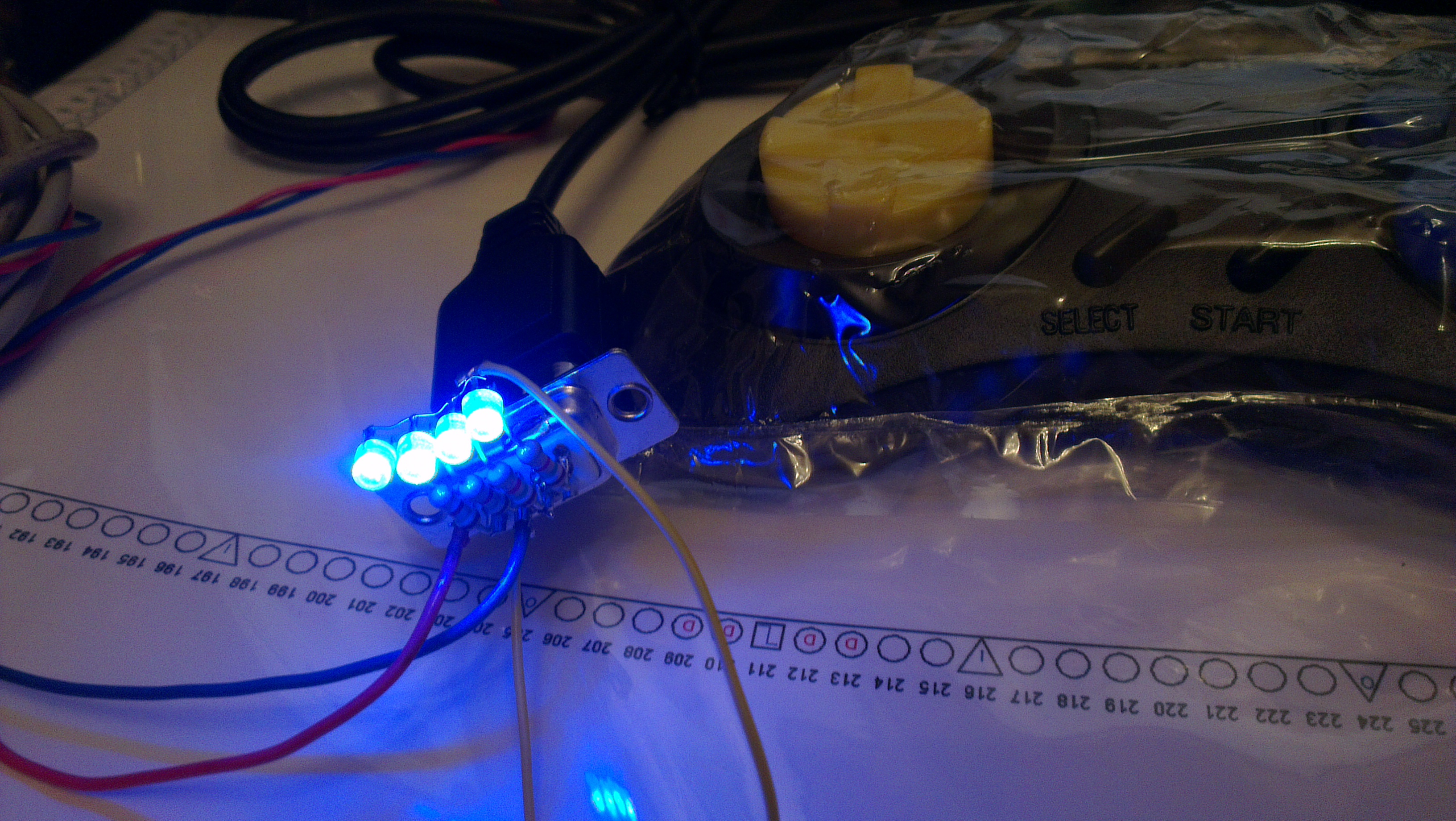

After applying voltage, the joystick has a high level of outputs. More than 4.6 volts !!! I just checked it on three different joysticks (of course, Chinese ;) ).
And I remember exactly that the original four button joysticks have a multiplexer without a Z state.
